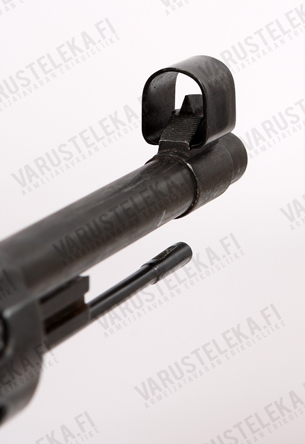

For the triangle count it's about as detailed as it needs to be. I'd pay close attention to the gun itself though, the details are mostly there - they just need refining. A couple of areas you might be able to close up a bit (from what I can see)
Front sight: http://www.varusteleka.com/pictures/2039.jpg (sight hood needs bringing up a tiny bit)
Front bracket: http://jakesgunreviews.weebly.com/uploads/8/0/6/8/8068894/915239782.jpg?902 (the bracket at the front needs a fair bit of reshaping)

I can fix the front sight & braket pretty easily. But redoing the stock is a tough job, considering that that's why took up a majority of the 4 hours it took to make this. Nonetheless, I'll see what I can do. :)
