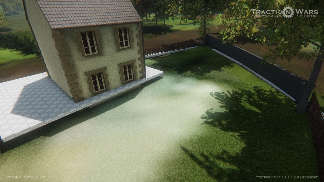

I’ll start of with this empty area that you can see in front of you. In our first part by Mars we talked about how we make use of historical maps and references to pin-point exactly where buildings were located and position them accordingly. You may notice that the ground has already got a lovely grassy terrain texture, created using the steps RvtL discussed in second part.

I start off by “white-boxing”. In other words, placing plain boxes to form the basic shapes of the agreed game-design. The concept is that the bigger boxes are buildings and smaller, thinner boxes are walls or fences. In the image above you can see both a wall on the right and a fence on the left. The wall provides great cover. While the fence provides only visual cover and allows other players to flank the position."
Then I like to place the larger objects, followed by the smaller objects which are key to the game-design element and the bigger trees/bushes. This all gives a better idea of how the scene could look allowing us to tweak the design at this early stage.
It’s important that we always white-box before beginning with the environmental element (small props, decals, plants etc..) so you end up with a properly balanced and thought through environment and game area. It helps to prevent time-consuming changes later in the process which are inevitable if we go straight into the detailing stage.
