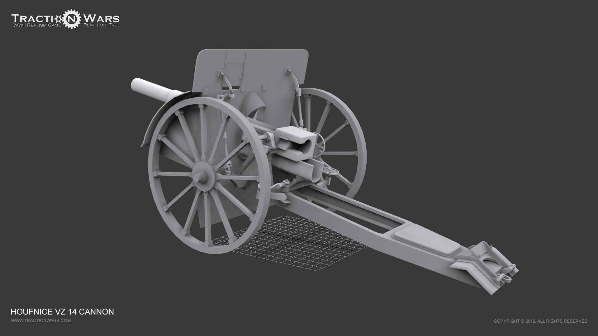

With methods outlined in previous devblogs 1, 2 and 3, the model and textures were created for the cannon.

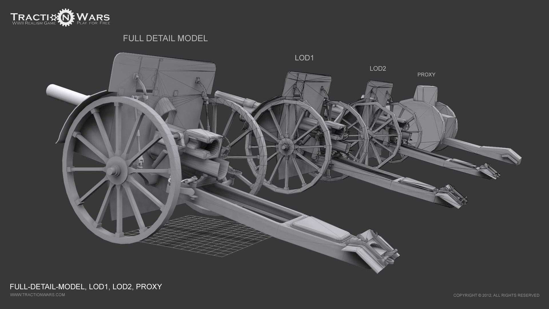

Due to its high level of polys, lod models (level of detail) were essentially to help the optimisation of the asset. The asset consisted of four models: the render mesh (high detail model), lod1,lod2 and the proxy. Lod1 is usually approximately half the poly count, lod2 being half again – i.e. a quarter of the total poly count of the original full detail model.

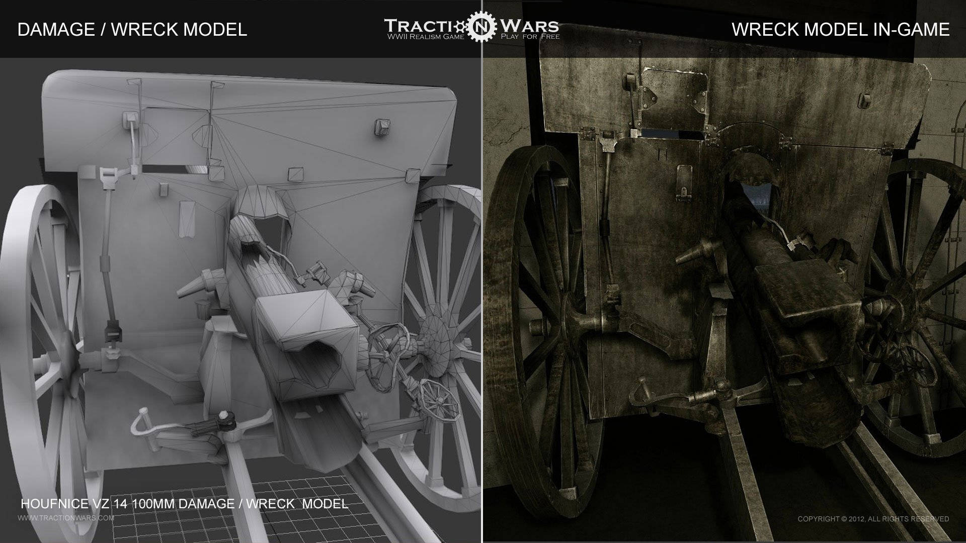

This poses some difficulties and extra hurdles that must be met, more so than a regular asset such as a building. One being the fact that a damaged incarnation of the model needs to be created – to accomplish this, a variety of techniques need to be brought to bear the first being to alter and cripple the mesh a little to represent the impact of a explosion of the base of the gun barrel. Along with that dark shades were painted on-top of the mesh using vertex mapping, to represent shine and burnt marks of the surface of the barrel.

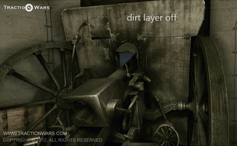

Further additions were made such as an altered texture and most importantly the use of dirtlayers, in cryengine 3 dirtlayers are applied by first painting onto the model the location of where you want the dirtlayer to show on the model – black is where the dirtlayer will show the strongest and in the white areas the dirtlayer will be totally transparent. Once in-engine the dirt layer can be selected in the material tab.
For this I chose a singed burnt tileable texture to overlay on-top of the damaged area of the model to further sell the effect of a disabled 100mm cannon – this tileable texture was tiled by a factor of four to ensure a high quality resolution finish.

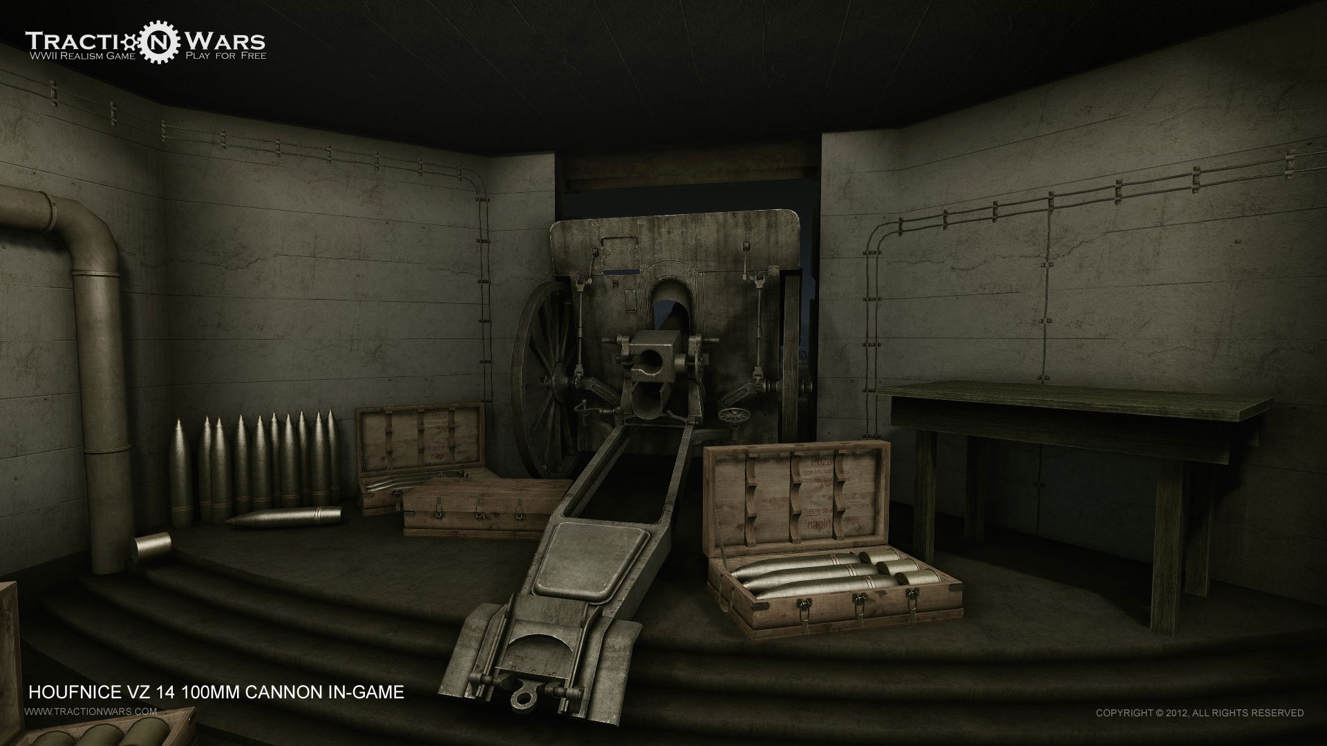

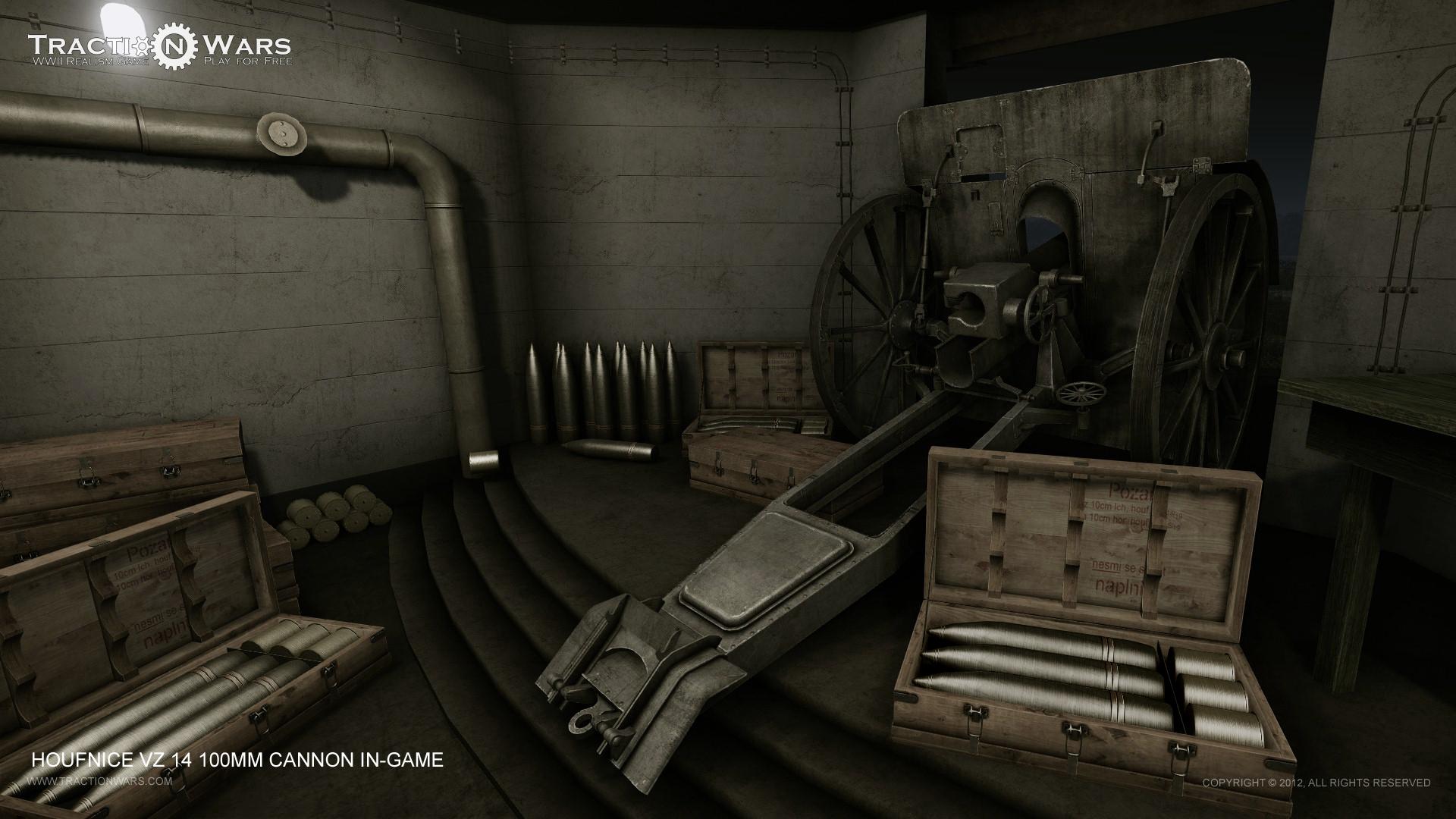

Finally for further finishing touches to the scene, accompanying objects where created, in this case ammunition boxes and 100mm shells. These were placed in around the gun to effectively sell the scene visually. One cannon on its own would look rather odd in an empty bunker so small objects like this are essential in selling the effect of a habited operational gun room – as well as being useful in other scenes on a wide array of other maps . The finished gun room panorama can be seen below.
