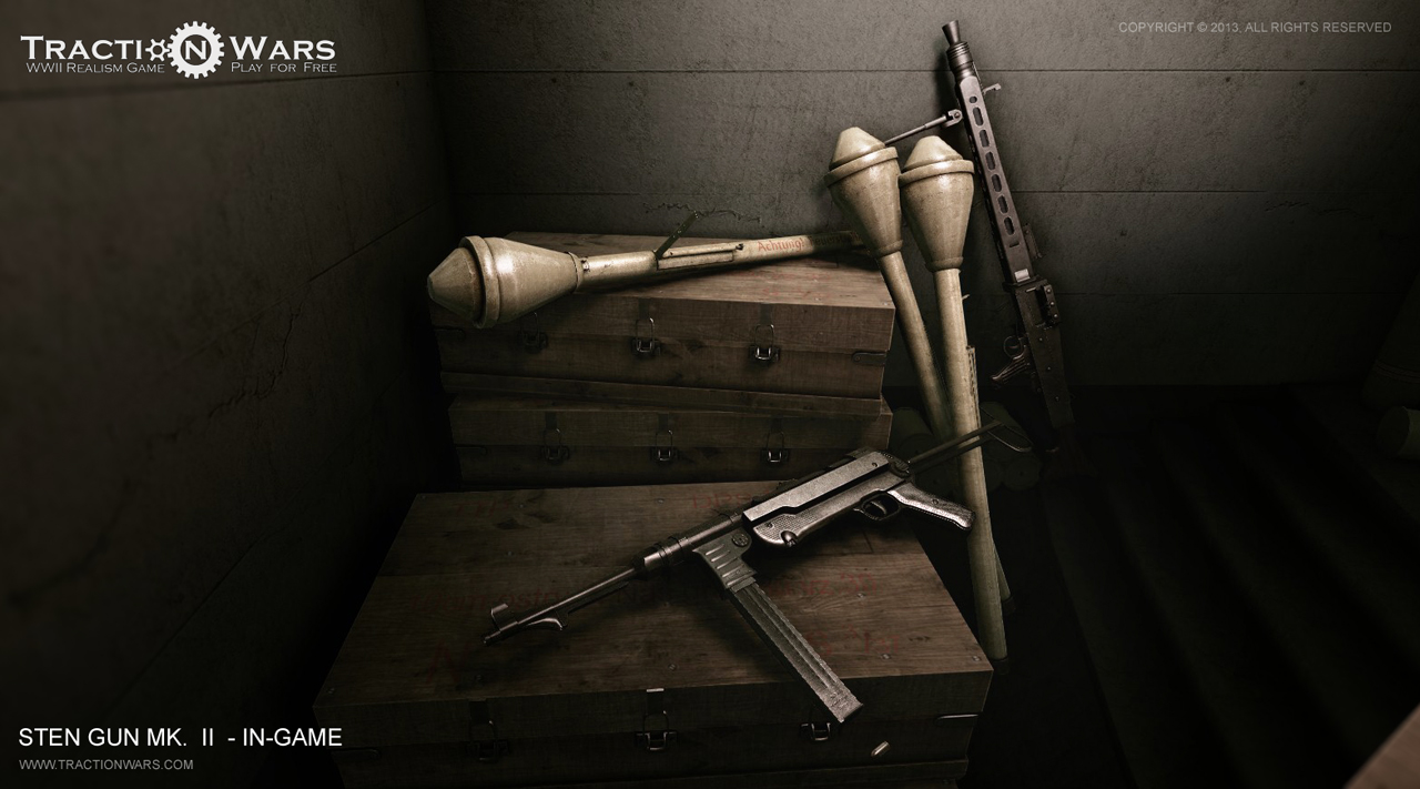

Sorry, I don't know my fausts xD Does the 30 have just one peephole in the sight? For the heck of it I Google image searched "panzerfaust 30 sight", and this was among the results. How have I not seen this before?! Gorgeous! And to think this is from 2013... I really would love to see some more weapons pics...
Don't mean to derail my question, though. What does the 30 sight look like? @Mars I don't know what implementing adjustable sights entails of course, and if it's a real hassle then I can think of other things I'd rather see, but were it possible I think adjustable sights on some weapons would be useful, though I can see most weapons being fine without them. It's those damned ATs and their trajectory...
Okay, three peepholes as I thought... if we can't adjust, how are we supposed to hit something beyond thirty meters?
