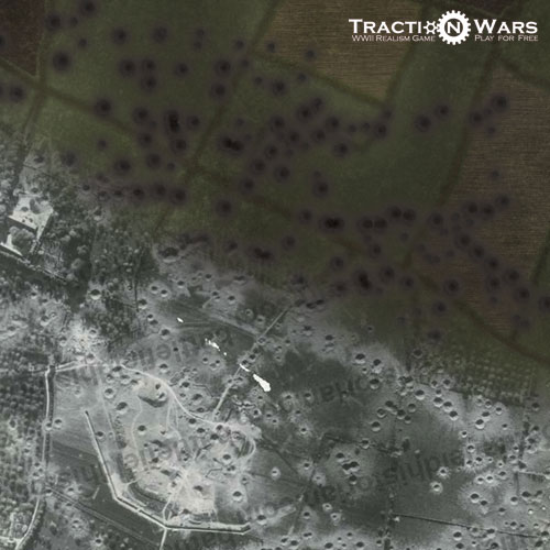

Thanks to aerial photographs and historical documents we discovered that Merville was heavily bombed by the RAF and USAAF in the month leading up to the invasion of Normandy. The picturesque French country side was littered with craters. We can easily recreate this using the height map by overlaying the aerial photographs on the map and accurately sculpting the craters exactly where they were in real life.

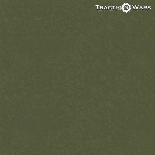

From the height map we move on to the terrain texture, which starts out as a large image which covers the entire map built up in several layers. The first layer is usually a grassy green, since that is the most common terrain type. The following layers add patterns and details like ditches, craters and fields.
Whilst it's also possible to paint the terrain texture in CRYENGINE’s Sandbox editor, we prefer creating a large image in a program like Adobe Photoshop, allowing us to pack a lot of intricate details in the texture with relative ease. Of course, the images presented here are WIP and are subjected to further revision and improvement!
Finally, to complete the terrain we add different materials for grass, gravel, mud and so on. This is one of the areas where CRYENGINE really shines; by combining a number of flat images it is possible to create a detailed three dimensional looking surface.

Thanks Maniche! Another question, regarding this link below:
http://www.tractionwars.com/images/media/2014.10-2/2014.10-2_03.gif
For doing this, do you achieve this with the "export/import terrain texture" tab (in the Editor of course)? Also, in the link above is the first image - the first basis for the texture, and the last is the final version you import into the engine?:
http://i.imgur.com/e2ByHxL.jpg
Thanks in advance :)
Regarding this thread again, this image is so cool (as well as the four texture maps that achieve it)!
RvtL
For doing this, do you achieve this with the "export/import terrain texture" tab (in the Editor of course)? Also, in the link above is the first image - the first basis for the texture, and the last is the final version you import into the engine?: http://i.imgur.com/e2ByHxL.jpg
yes, the gif basically shows the different Photoshop layers. The last image is the one we import using the function you mention.
